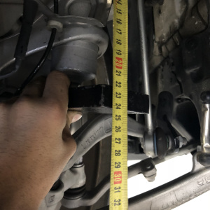

[QUOTE=whoop_ass;23382660]
Originally Posted by goaty View Post
Here's the measurements of the perch from both the driver and passenger side. We leveraged a block pressed against the bottom of the strut to get a more precise measurement. They were literally identical:
[/QUOTE
great thanks for the pics
so before your measurements differed?
I have 10mm difference between left side and right :-(
Honestly, I never measured I just assumed that since there was such a heavy difference from side to side that they most certainly had to be off. I was wrong. They're identical. I even went in with the little slab of metal they used to measure to ensure they weren't "tilting" it to favor the same measurement and it's square. The perch that is pressed on to the strut couldn't go any lower and sat flush with the tool provided with the kit (the heavy sleeve thing).
