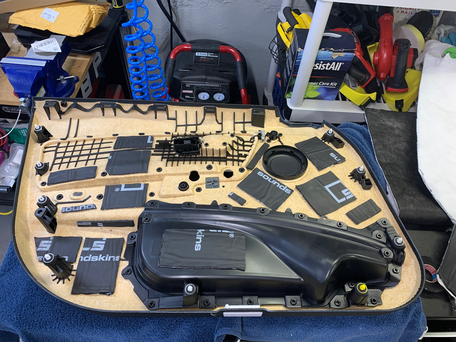

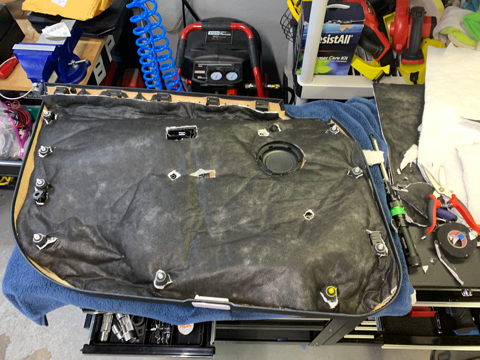

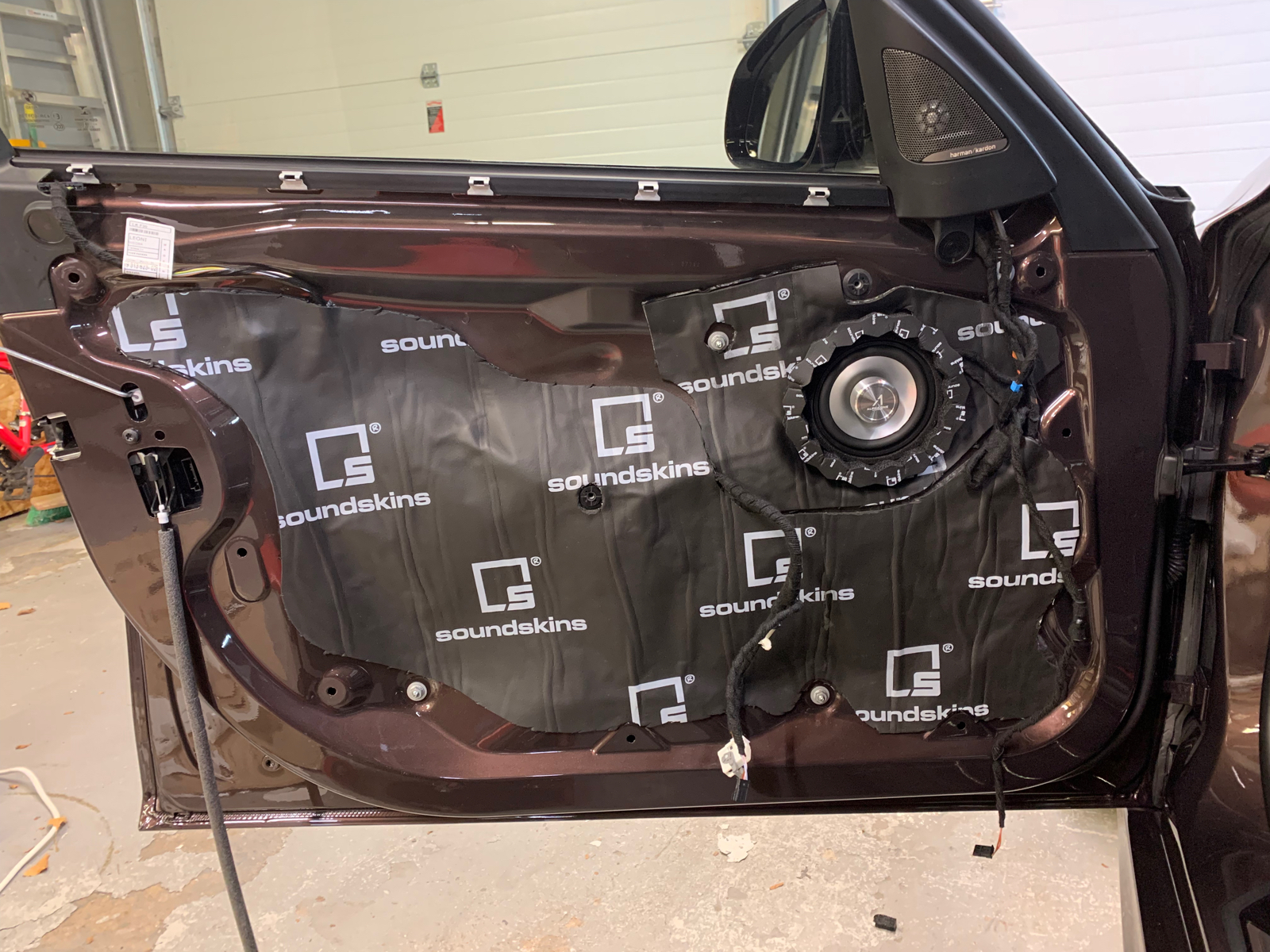

You might want to consider adding some sound deadening and quieting to help further enhance your sound system upgrade. A few pics below of a recent weekend endeavor to "prep" for my future upgrade…

Hey guys, I finally completed my Match UP10DSP install (without the trunk sub for now) and did an initial DIY tune. I posted my initial thoughts about it in another thread in the F30 forum here:
https://f30.bimmerpost.com/forums/sh...udiotec&page=2
