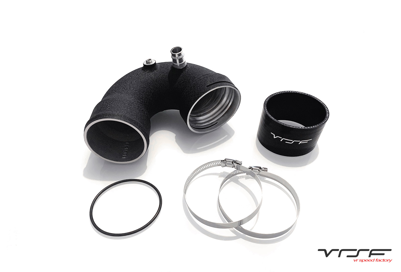

The aftermarket piece seems to have a more restricted flow than the OEM one, due to its shape. What is the point of replacing the OEM piece if it hasn’t failed?

This is what the newest version of our charge pipe looks like:

Ah, this makes sense. Thank you...
