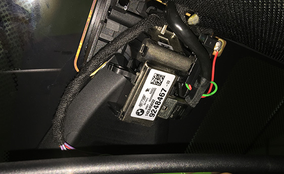

I drove over some crappy roads over the weekend and discovered a new rattle coming from central area of the dash. I thought possibly the A/C Vents or the dome light area. Tried the A/C vent fix but that didn't do anything and pushing on the dome light assembly didn't quiet the noise.
Found out the rattle was coming from a module under the rear view mirror cover. I believe it has something to do with the high beam assist and forward collision alert system. When I push on it, the rattle goes away.
Since I might need that part swapped out, I'm planning to just relay the info to my service advisor and have them fix it.
Just thought I'd share this finding for those that might have a stubborn center area rattle that you haven't been able to find.
Since I might need that part out, I'm planning to just relay the info to my service advisor and have them fix it.
