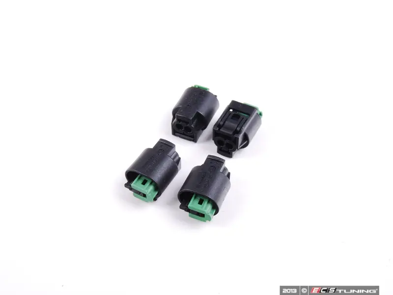

I bought a set of used KW V3 coilovers on the forum here that included KW's EDC delete kit. Unfortunately, what I received is missing a critical piece, the connector locks.
They look like this and I can't find any info on what these connectors are (whether generic I can find elsewhere or proprietary to KW). I've tried researching and contacting KW with no success.
Any help would be appreciated on finding these connectors or a workaround. Thanks!

What did KW say? I mean they have to get them from somewhere. I would check AliExpress as I’ve gotten BMW connectors from there before.
This looks to be them?
2 Pin Tyco AMP Male And Female Outdoor Temperature Connector Socket Auto Oxygen Sensor Plug For BMW 1-967644-1
https://a.aliexpress.com/_mOzT7CM

You have literally made my day! I was so bummed I was never going to find this. Picked it up for equally as cheap from Mouser and should arrive in just a few days. Thank you!! https://www.mouser.com/ProductDetail/571-1-967644-1

I have the opposite problem. Someone had coilovers on the car and left the edc delete on and the oem shocks unplugged. I was installing a HAS kit and want to plug the oems back in. Anyone have the part number for the oem plugs?

I got some from ali express but BMW dealers should have them as well. Been a while but something like this: I just found this on AliExpress: $7.14 | 5/20/100sets 1 2 3 4 6Pin Way Delphi 2.5 GM Automotive Female Male Weather Pack Electrical Socket Plug Automobile Connectors
https://a.aliexpress.com/_mKx943N
They’re called Delphi connectors.
