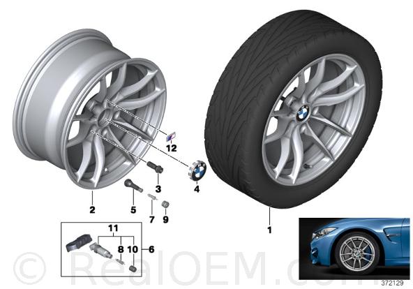

Im Looking for the part number for the front 18 513M wheel. Anyone?
201X ???? Coming soon
2015 F80 M3 AW/SO - Going Going Gone!
      09-26-2014, 12:39 PM   #9
tom @ eas
tom @ eas's Avatar
8868
19,184
Location: Anaheim, CA
2018 BMW i3s  [5.00]
2010 BMW M3  [6.50]
2015 BMW M4  [6.20]
Part numbers are as follows:
ALLOY RIM FORGED 9JX18 ET:29 36112284750
ALLOY RIM FORGED 10JX18 ET:40 36112284751
http://www.realoem.com/bmw/showparts...27&hg=36&fg=15
