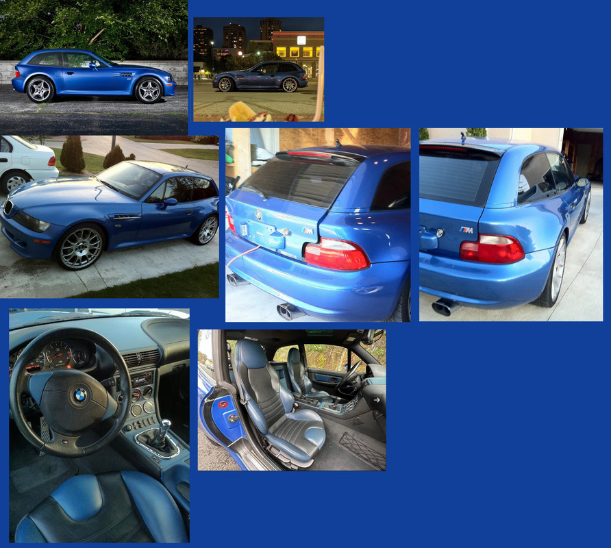

My buddy is looking to sell me his '99 S52 M Coupe Clown shoe in Estoril Blue with 102,000 miles for around $33-35k (Canadian dollars).
Originally a California car, it made it's way up to Canada and he bought it in ~2012 when we were in our 20s and it was such a fun car until he sold it for an E46 M3. He bought it back from the guy he sold it to a few years ago and now he's looking for me to be the next custodian of it.
It's got an AC Schnitzer classic exhaust and both the OEM wheel set and a set of BBSs. It's in fantastic shape inside and out. He's one of my closest friends so I trust the car doesn't have any gremlins to his knowledge and he has kept meticulous care of it beside his 996 GT2, 997 GT3 and 996 Turbo. We're just hoping to "keep it in the family."
I think it would sit nice beside my new G82 and '96 Integra, but I don't know tooooo much about S52 Clown shoes other than I remember really loving driving it way back in 2012...we don't live in the same city anymore but I'm planning to visit in the spring to take it for a spin.

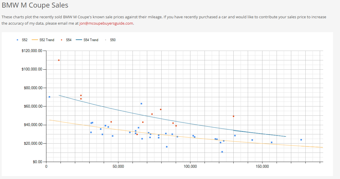

I would say @M-technik-3 covered things really well. I would also say the price is pretty close to market. I have an '01 Z3M roadster. Great car and love driving it.

With 100k miles I'd say $21k USD is a fair to good deal in your favor. Like others have stated, the subframe issue is real. Randy Forbes still makes kits and I would highly suggest finding a shop that's done a repair so they know what their getting into.
