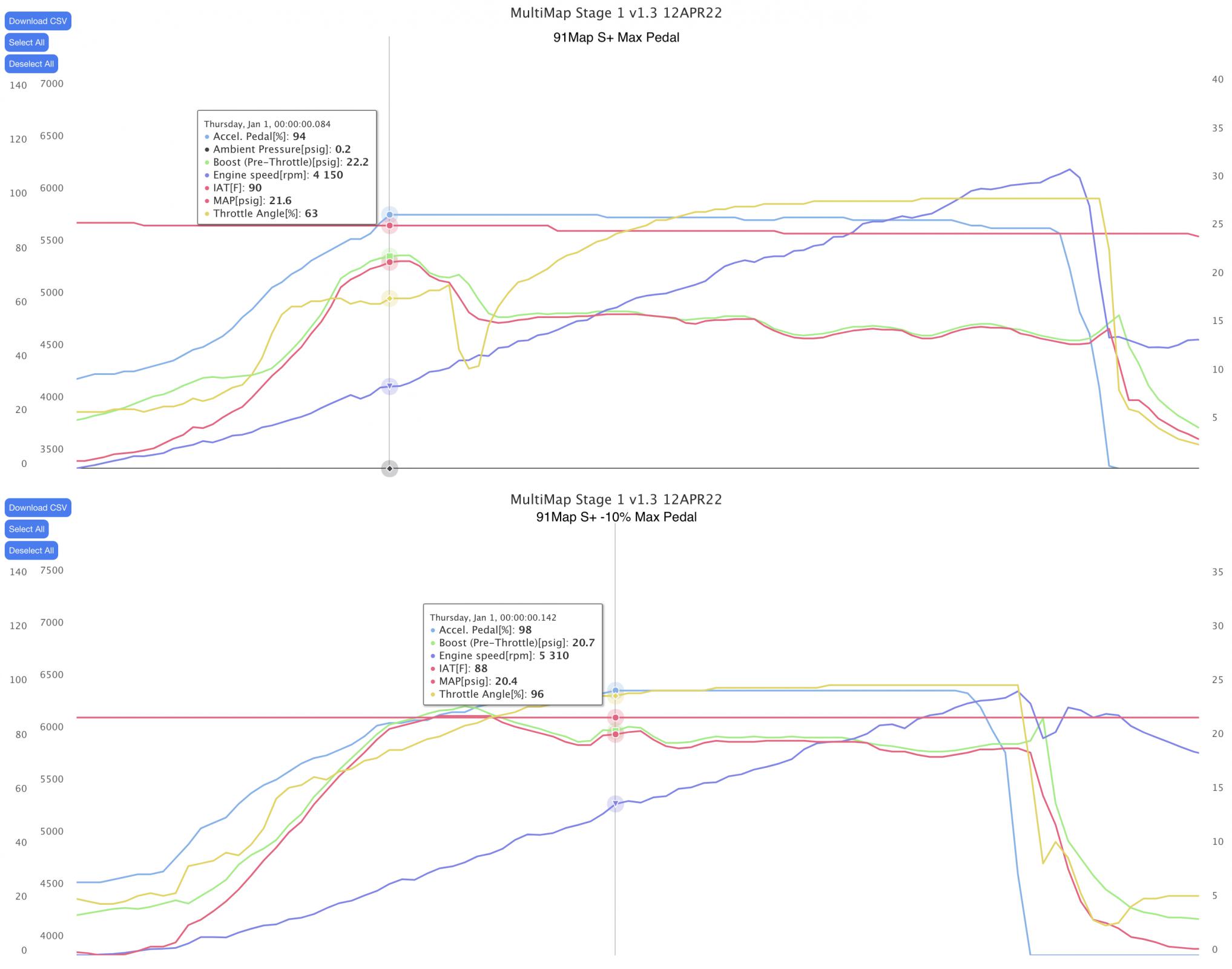

Ok. I have the day off and it's my birthday and I got to freely nerd out on my car - great day so far. Here's what I found after running multiple logs:
BLUF: Throttle sensitivity modifier does not de-tune the maps, but it does delay or slow actual throttle position compared to the requested pedal %. Instead of 1:1 pedal to commanded throttle position in S+ -0%, S+ -10% will achieve the request at a slower rate commensurate with the reduction in sensitivity.
Test:
Stage 1 91 map selected, Sport+ and Sport+ -10%, 3rd gear, ~3500-4000RPM start, TC on full (I know this impacted the data and I'm a pussy - deal with it). From a roll at the mentioned parameters I floored the pedal and held it until approximately 6k RPM. S+ minus 10% was done first followed by S+ full-up. The car was not fully cooled between tests, so some heat soak could have affected the latter runs.
Data comparison points: max boost, max pedal, max throttle, 5k RPM
Graphs:
Each picture is the comparison point with both logs; top being S+ full-up and bottom being S+ minus 10% sensitivity.
Issues:
TC was engaged on all runs with the throttle sensitivity modifier set to 0 (i.e. stock S+ pedal feel). I repeated this run 3x with the same results, so I accepted the data. I realize that this will likely skew the data and make quantitative results unreliable. TC did not engage on any runs done with S+ nerfed 10% (which is significant). Note: I did warm the tires and do the pulls on a sunny, flat dry road (in Mexico). Rear temps were 85-90 deg F on 3 week old 295mm Conti EC Sports.
Results:
Peak Boost: Peak boost occurred slightly earlier on S+ vs S+ -10% (4,154 vs 4,751 RPM respectively). All other values were nearly identical except for a 4% accel pedal advantage to S+ and a 23% throttle angle advantage to S+ -10%. The significant difference between throttle angles is most certainly due to TC activation (and it can be seen when visually comparing the yellow graphs).
Max Pedal: Max pedal was achieved significantly earlier on S+ vs S+ -10% (4,150 vs 5,310 RPM respectively). The only two sources of this would be human error and the sensitivity modifier. While I believe I floored the pedal evenly on all tests, it's certainly possible that I messed this portion up. This could also be a result of the sensitivity modifier programming a delay for throttle input as the method to achieve a reduced feel. The most significant difference in values at this point is throttle angle 63% vs 96% on S+ and S+ -10% respectively. Again, a consequence of TC activation seen on the yellow graph.
Max Throttle: Max throttle is achieved first for the S+ -10% setting over standard S+. Again, results are dictated by TC activation. If we note the steep curve on the S+ graph beginning about 1/3 in, we can see an extremely sharp logarithmic curve. We would expect this on an unmodified S+ throttle because of the unfiltered 1:1 input to throttle command. Based on that, without redoing the test on a drag strip with TC fully off, I would assume the S+ actually actually achieves max throttle faster than S+ -10%. Maybe a better comparison to remove the TC issues would be to compare throttle request vs actual as a rate (pedal vs throttle angle over time from the start of the input). But I'm not going to do that.
5k RPM: The final data point I chose to compare shows S+ -10% winning out in a few areas; shortest time (slightly), boost and throttle angle. AGAIN, TC engagement would likely create this result. However, it is interesting to see that S+ boost remains stable approximately 4 PSI lower than S+ -10%. I would have expected to see that value matched after TC turns off.
Conclusion:
Based on the things we can quantify, it does not appear that reducing pedal sensitivity "de-tunes" the car. Pre-throttle boost and all other performance related values remain unchanged, however it is clear that those values will be reached at a slower rate than unreduced sensitivity. I say this because of the activation of TC. Reducing sensitivity will result in a slower request of max power resulting in reduced acceleration. In the testing today, this actually resulted in a faster car due to keeping TC uninvolved and the avoidance of wheel spin. Now, what to do with this information? I think there is merit to using the reduction in sensitivity to avoid TC intervention and unwanted wheel spin, however 10% is too much. I believe 5% would be beneficial while not impeding acceleration by a noticeable amount. OR you could just use S+ as designed and modulate the pedal.
Where to go from here:
I'm going to do more testing. I plan to compare 0% reduction and 5% reduction in 4th gear from 3k RPM and TC off.

Today I re-ran the test.
Stage 1 91 map, 4th gear ~3k rpm, Sport+ unmodified vs Sport+ -5% sensitivity and TC off. Rears were ~80 deg F on a warm dry black asphalt road (in Mexico).
This time I ran an auto-log starting when pedal exceeds 35% until 2sec post lift.
The graphs look super similar. The only noticeable difference I can glean is that the S+ log reaches full boost slightly earlier than the S+ -5%. What is most alarming is that the log says my peak boost was in the 30s... Clearly that is not possible. I must have fat-fingered a setting for pressure relative vs absolute or something, because it's normally in the low 20s.
Anyway, my conclusion is still the same: you get a softer, less harsh pedal at the cost of performance. I bet if I cloned my cars and ran the test the S+ -5% would be a hair slower, probably un-noticeably so. I bet there would be better info if someone with a dragy ran a test.
Other opinions obviously welcome.

My idea about this is that with accelerator at 100% in both cases... they should work the same...
the big difference is when we move smoothly through the city or highway at a speed maintained at a pedal percentage of between 10 and 20%.
Is there an improvement... does it look like sport+ to sport?
