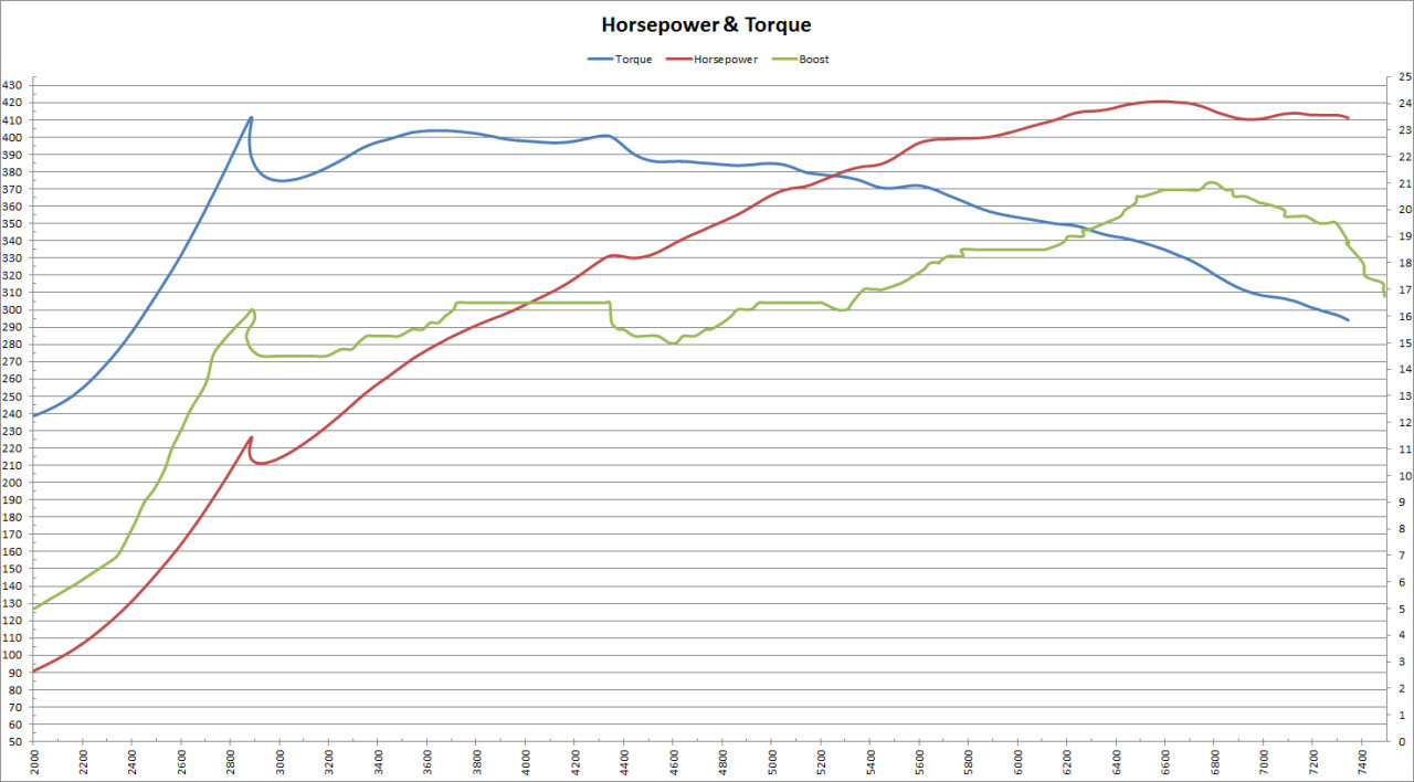

Boost was calculated using a 60-FPS video camera on the AWRON digital gauge and M4 instrument cluster for RPM. After downloading the Solo-DL data logs, we analyzed the video frame-by-frame to log boost data. We matched the dyno logs with Solo-DL logs to get RPM data we could use for the boost log. The RPM to video frame resolution was perfectly accurate (no extra frames at the end of the dyno run), and the AWRON boost gauge seems to have 1/4 PSI granularity. So the boost log above is in 1/4 PSI granularity and is per-RPM accurate.

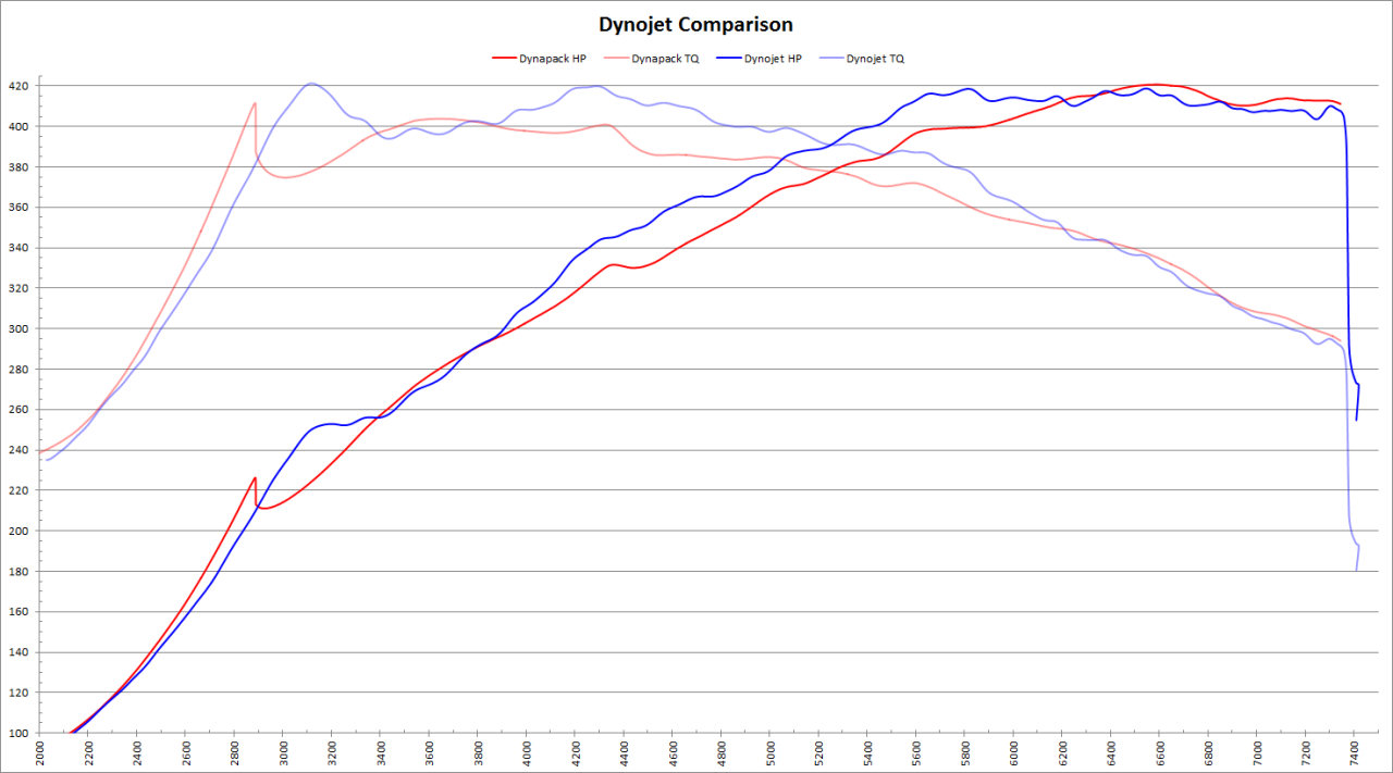

Comparing Dynapack to Dynojet Results:
I've seen lots of people asking about comparing Dynojet to RRI or Dynapack. I'm not making any statement about what it means, but here's what the comparison looks like.

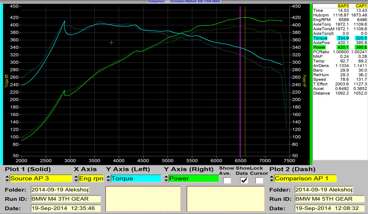

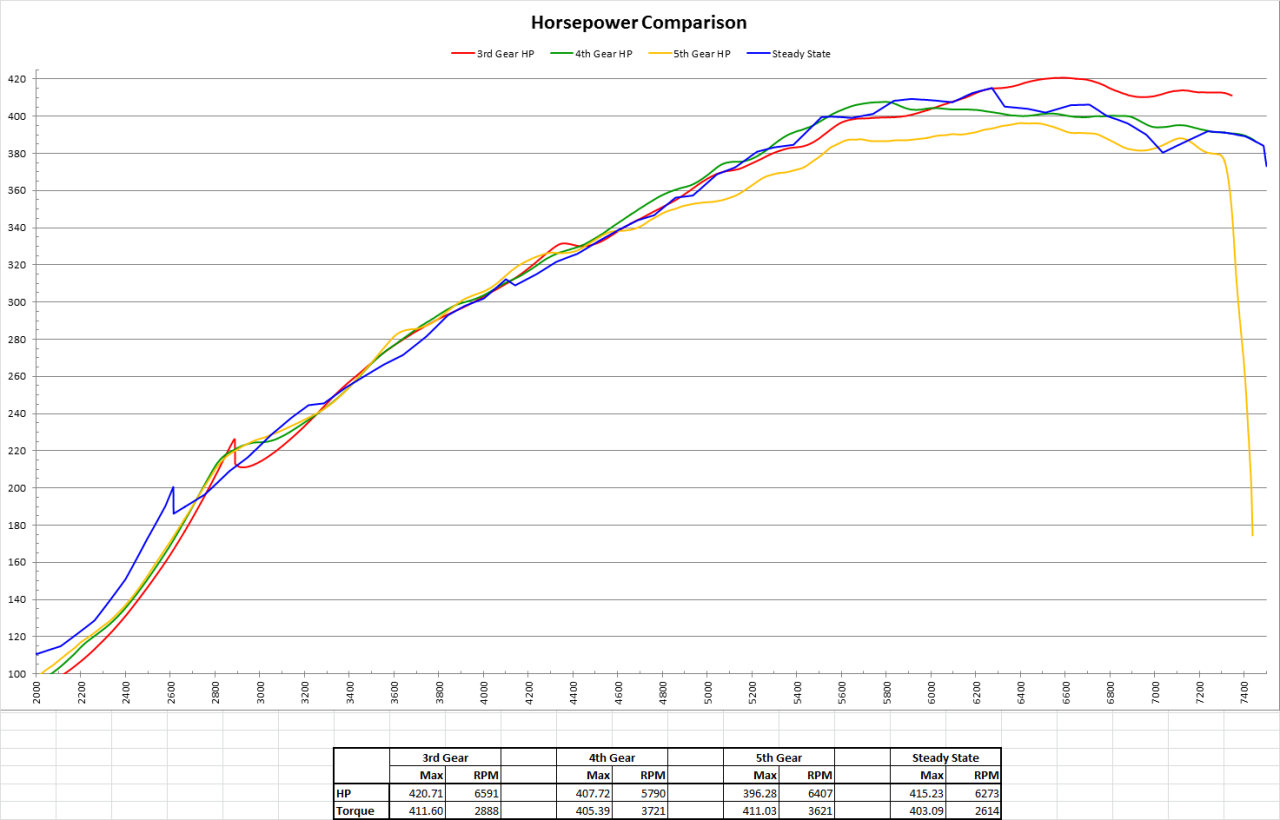

Selecting the gear ratio

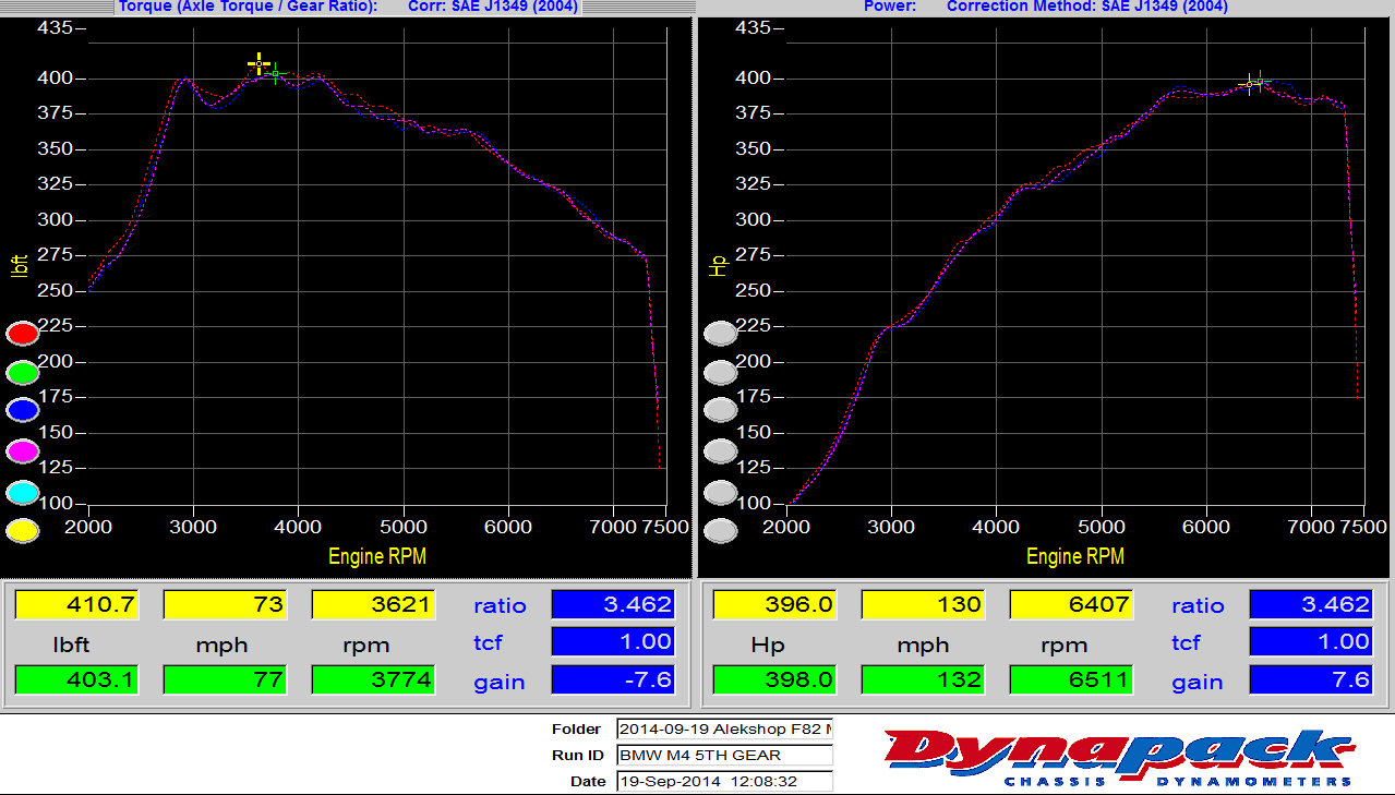

5th Gear
We started testing in 5th gear because it's 1:1 and many people prefer using this gear. From the E9x M3, we settles on a ramp rate of 1000 RPMs per 4-seconds because it seemed perfect to eliminate the effects of inertia, and match steady state testing. So we started testing in 5th gear at 1000 RPMs/4-seconds. We obtained a reliable and repeatable 396-399 whp.

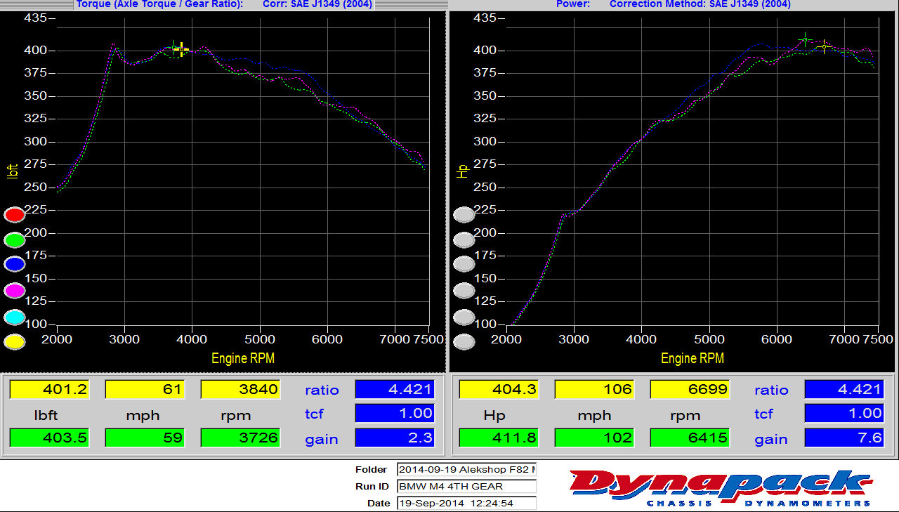

4th Gear
Next we reprogrammed the Dynapack for 4th gear but kept our 1000 RPMs/4-second ramp rate. This test gave us a reliable and repeatable 405-412 whp.
3rd Gear
We finally programmed the Dynapack for 3rd gear and still kept our 1000 RPMs/4-second ramp rate. This gave us our best results. Using 3rd gear, we obtained a very consistent 418-420 whp.
Comparing Gear Ratio Results: 3rd to 4th
Even though we did the remainder of our testing in 3rd gear, after getting home we started comparing the different gear ratio results to see if it all made sense. It seemed very clear that the power was identical up to a certain point. Comparing 3rd to 4th gear, the power was identical from 2000-5800 RPMs.
Comparing Gear Ratio Results: 3rd to 5th
Comparing 3rd to 5th gears showed similar results. The power was identical up to a point, but afterwards they drifted apart. In the case of 3rd vs. 5th, the power was identical from 2000-4600 RPMs. The fact that the power is identical but diverges sooner than 4th gear tell us one of two things: 1) the ECU is programmed to make different amounts of power in different gears, or 2) our RPM ramp is still too fast for higher gears -- and they are experiencing the inertial effects we are trying to eliminate.
The low ramp speed makes some sense because the 5th gear diverges sooner than 4th gear. We didn't test this theory on this trip because we ran out of time. We might revisit the ramp speed test and try different values for higher gears to see if it makes a difference when the car is tuned.
Comparing Gear Ratio Results: 3rd to Steady State
During this dyno session, I wanted to test another theory floating around the F8x dyno debate threads. Will steady state testing produce significantly different results than a carefully constructed ramp test? In theory, steady state will produce significantly different results because the inertial effects of the drive train are completely eliminated. But is the theory really backed up by reality? We've done this before with the E9x M3, and found we could carefully construct a ramp test to equal steady state testing. But since this is a new car, new chassis, new engine, we thought it would be a good time to put it to test again.
Our ramp test still used 3rd gear and 1000 RPMs/4-seconds. Our steady state was 1-second for each 100 RPMs increments. At each 100 RPM intervals, the Dynapack would hold the engine for 1-second, measure the torque, then move up 100 RPMs for the next test. This is hard on the car and engine because this isn't how you drive. So we only did this test long enough to confirm or deny our previous experiments. If the results confirm, we quit...no need to continue testing to prove anything else.
The graph above clearly shows equality between our ramp test and steady state tests. The steady state test kind of falls apart at 6300 RPMs. This is almost surely because of the extra heat build up in the turbos, coolers, etc. over the ramp test. It's very important to understand: if there are inertial effects, the ramp test results will be LOWER, not HIGHER than steady state testing. So just as the E9x M3, a carefully constructed ramp test can equal the results of a steady state test, and the inertial effects of the drive train are effectively mitigated.
Last but not least, here's a complete picture of all the results from each gear and steady state tests.

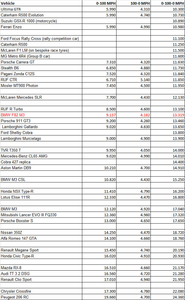

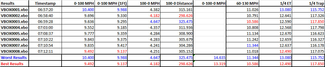

After the dyno results, we took the car to "Mexico" for some vBox tests. Using the same tank of 93 octane gas, we headed to Mexico for some vBox testing. We used our higher resolution vBox Sport (20 Hz sampling) for greater accuracy. We also data logged with the AIM Solo-DL for back up. We ran the car in eight identical tests: 0-135 MPH, slam on the brakes and back down to 0 MPH. Four runs were made in one direction, and four runs were made in the other direction on our Mexico roadway. There's two things running against us on these tests: 1) Street tires instead of drag radials; 2) Road was very rough, and this will definitely hurt the performance. But regardless, we made the best of it to bring some real life data to the discussion.
Using this method, we can obtain the following test results:
  • 0-100 MPH (1)
  • 1/4 Mile Drag Race (2)
  • 60-130 MPH
  • 100-0 MPH (Braking)
  • 0-100-0 MPH (3)
Notes:
  1. 0-100 MPH calculated using 1-Ft rollout as per American car magazines typical methods.
  2. Trap speed and ET calculated according to official NHRA rules with www.vboxtools.com software, not using other vBox software that only calculates vMax. Results equal drag race timeslips.
  3. Calculated by combining 0-100 MPH (1-Ft) time, plus 0.25s reaction time, plus 100-0 MPH time.
  4. Complete results and graphs for all runs are available at this location.
0-100 MPH: 9.492 Seconds
0-100 MPH (1-Ft Rollout): 9.137 Seconds
100-0 MPH: 4.182 Seconds
0-100-0 MPH: 13.319 Seconds
Back in the old days, a guy mashed the gas pedal, watched the speedometer, and mashed the brakes when he hit 100 MPH. Without a vBox or other speed logging device, you never knew if you actually hit 100 MPH, or were falling short due to speedometer error. Then you have the reaction time to hit the brakes followed by the braking time. These days, we do things a little different. A magazine will typically make many runs up to 100 MPH, and make many braking attempts until they put the best of each together to create a single 0-100-0 result. It's easy for us to do the same thing with a vBox. This will also be a great way to test the Carbon Ceramic Brakes (CCB's) for things like brake fade.
Our 0-100-0 time is taken from our quickest 0-100 MPH time (1-Ft Rollout), and our quickest 100-0 MPH time. When you put the two together, you end up with 13.319 seconds. BTW, American car magazines use a 1-Ft rollout even on these types of ET tests from 0 MPH; that's why we're using the 1-Ft rollout version. Here's a spreadsheet to show how we rate compared to some other great cars.
60-130 MPH: 10.586 Seconds
1/4 Mile Drag Race: 12.590 Seconds @ 117.850 MPH
Performance Results Summary:
The car performed flawless. All of our performance results met or exceeded expectations. All of our runs were very consistent with only one outlier or two which came on the first run as things were getting warmed up.
The braking tests are worth a special mention. Our CCB's performed better than expected. When you look at those 100-0 MPH results, the M4 gave the second quickest 100-0 on record (on that list of cars). Granted I found evidence of other cars stopping 100-0 qucker than the M4 (as quick as 3.6s), but they don't appear on this list. So to be second quickest stopping car on that list is pretty impressive. I was also impressed how consistent the 100-0's were. There was only 0.5 seconds difference from quickest to slowest brake test. As the timestamps show, runs 6 and 7 were back to back. The CCB's didn't fade a bit. Just look at the braking graphs, the line is perfectly linear and doesn't start to curve even the slightest bit. This shows the CCB's don't fade a bit under a test like this. But I did get them to fade a little at the track.
I haven't seen any bone stock 60-130 times yet, so I'll enter mine at 10.586 seconds as the first one.
Our 1/4 mile times aren't the greatest, but they're definitely in line with other magazine tests. If the road wasn't so rough, and if we had drag radials, I'm sure there's at least another 1-2 MPH we can get out of this car. I never use launch control, it's not my thing. So I'm not sure how much, if any I would improve the ET.
Anyways, these are my results for dyno and road testing. I'll be happy to answer questions about our tests, but not interested in another over/underrating debate. Thanks for reading.

Given that conventional wisdom/practice is to dyno in a gear that is 1:1 or as close as possible, the 396-399 number seems reasonable on a dynapack (reduced rotational losses, albeit slightly).
I agreed that the car is severely traction limited off the line. I don't know, however, whether DRs would significantly improve the trap speed. The ET would fall dramatically but the trap may not change a lot.
