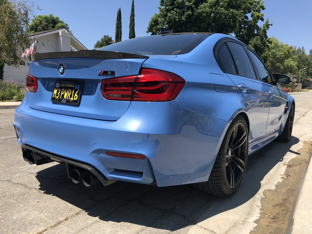

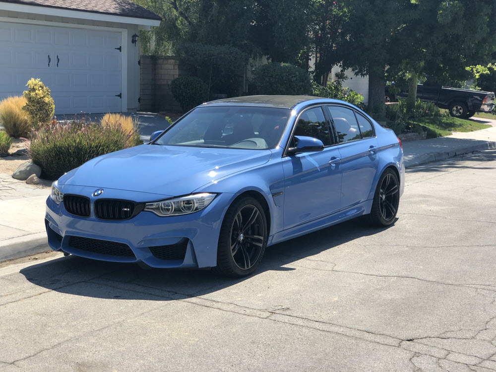

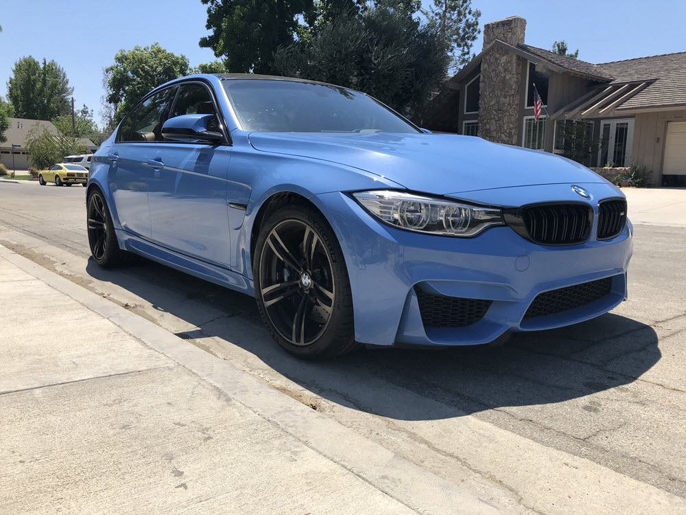

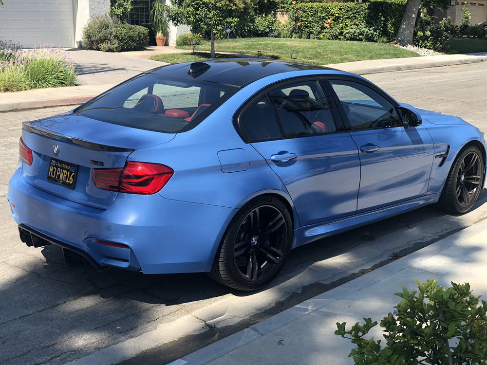

Here are some additional photos of my setup (265/35/19 & 285/35/19 on stock suspension). Would love to figure out why there's still a bit of a gap in front but all my play money just went to a pool so I'll have to live with it. Anyway 3K mikes in and I'm still amazed and how much better these tires are vs. the stock Conti's. Obviously the extra tread plays a major role not just the rubber but man oh man what a difference.
