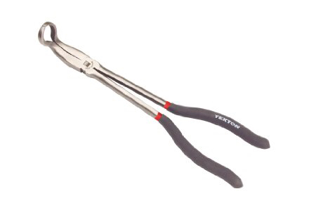

This tool makes it so much easier: Tektron 3495

how do you get the map sensor out. do you take the overflow reservoir out? thanks for the offer. I will try myself and if can't do it might need your help.

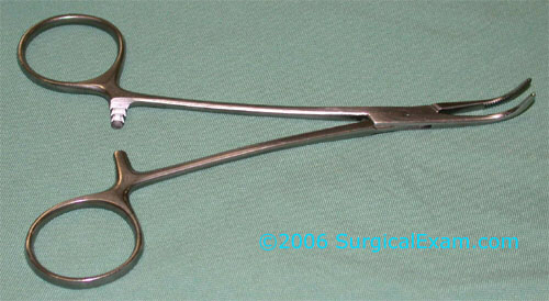

If there are Doctors here I used a long fine right angle to get to the Tmap. First install was over an hour without it. Just reinstalled in 10 minutes without touching the reservoir at all with this.
