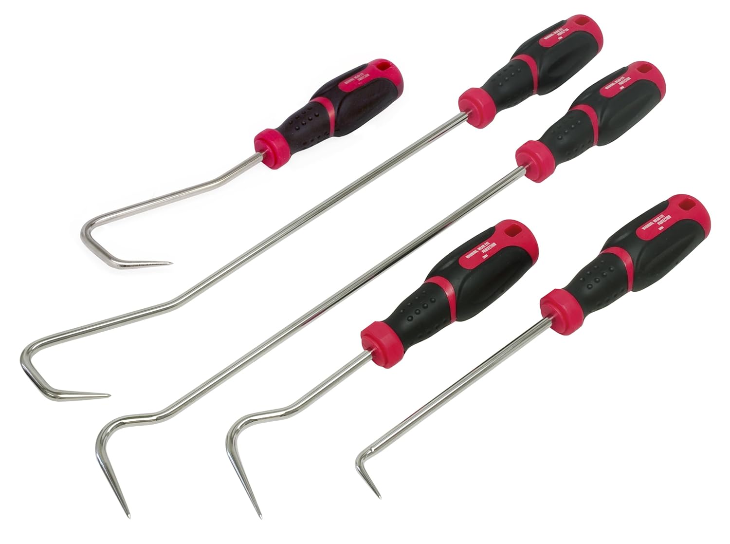

these tools will help

That would definitely help! I wish they had a grabber version, too.
Wish granted

I can install JB4 in stage 1 configuration in 15 minutes with this tool. All I have to do is pull back the weather stripping on the firewall, loosen the two T25 screws on the reservoir, and pull it up out of the rubber grommet. I DO NOT REMOVE THE COOLANT HOSE. Use the tool to grab the lip on the very back of the plug and should be simple to click it in.
The tool is well worth the $11 if you plan on doing JB4 install/removes by yourself.
http://www.amazon.com/gp/product/B00...?ie=UTF8&psc=1
