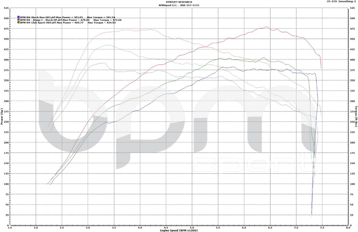

2015 M3 Stock vs. BPM Stage II+ Dyno - Stock Downpipes - 94 Oct
2015 M3 Stock vs. BMW M3 CS Software vs BPM Stage I Dyno - Stock Downpipes
