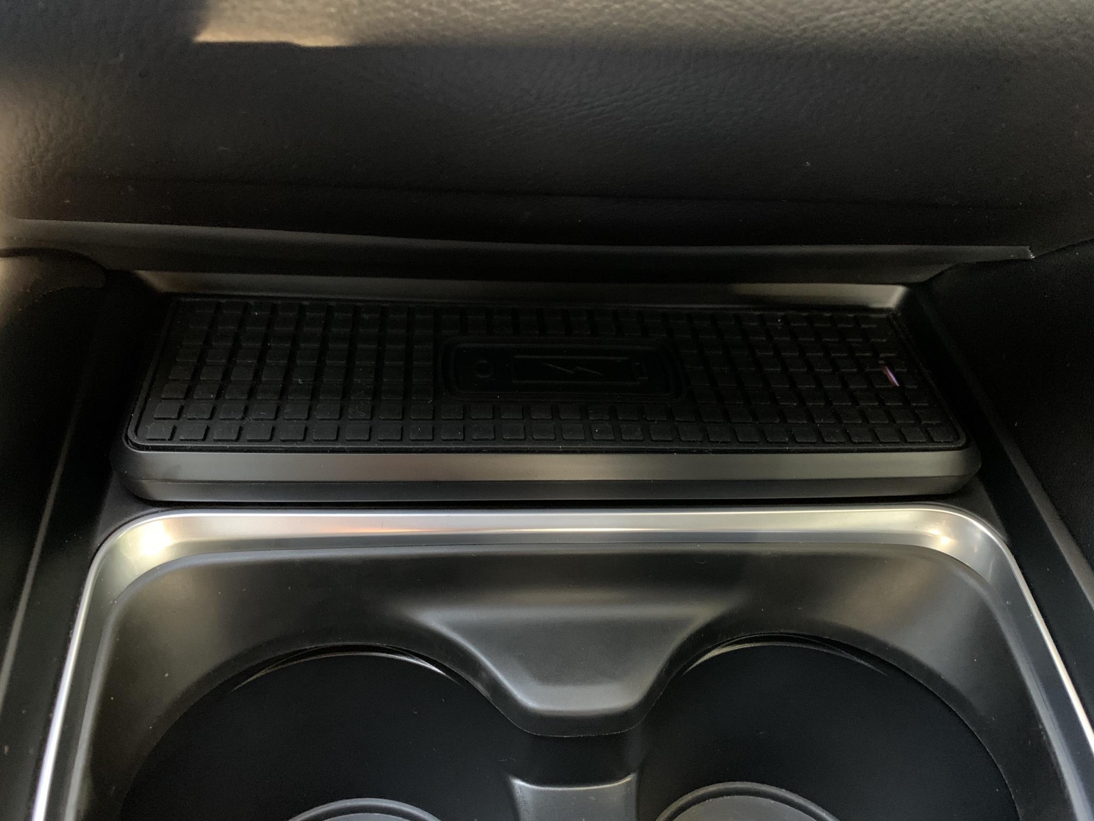

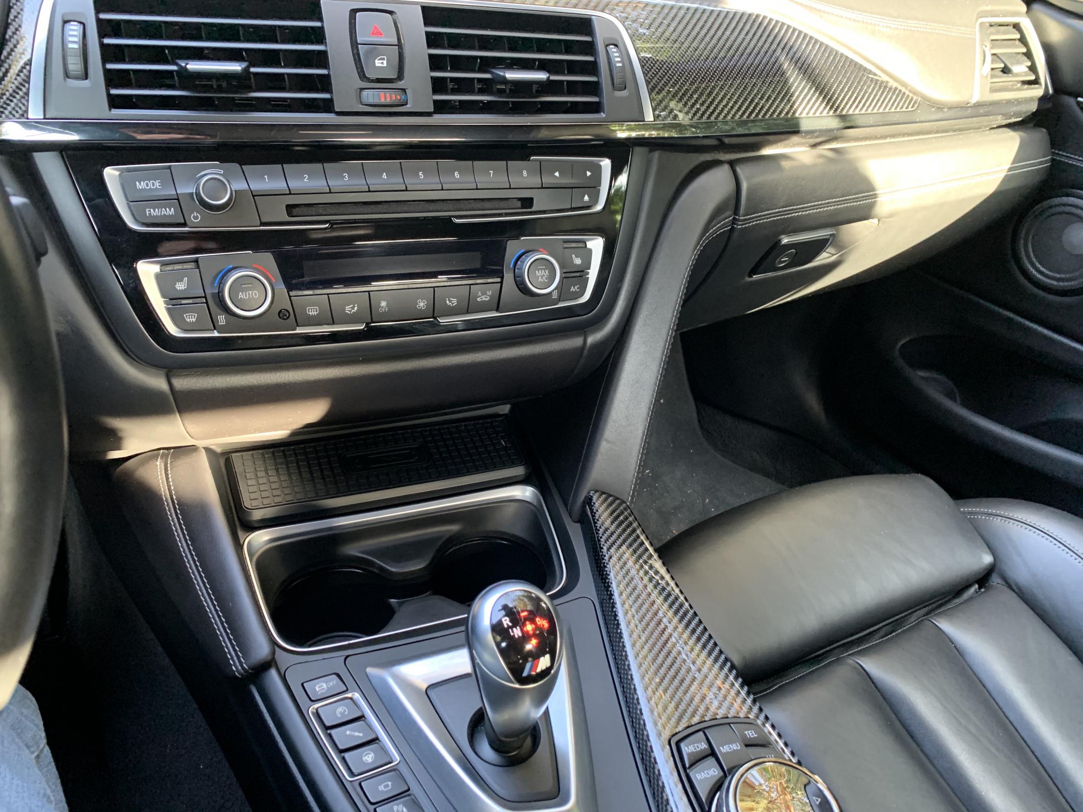

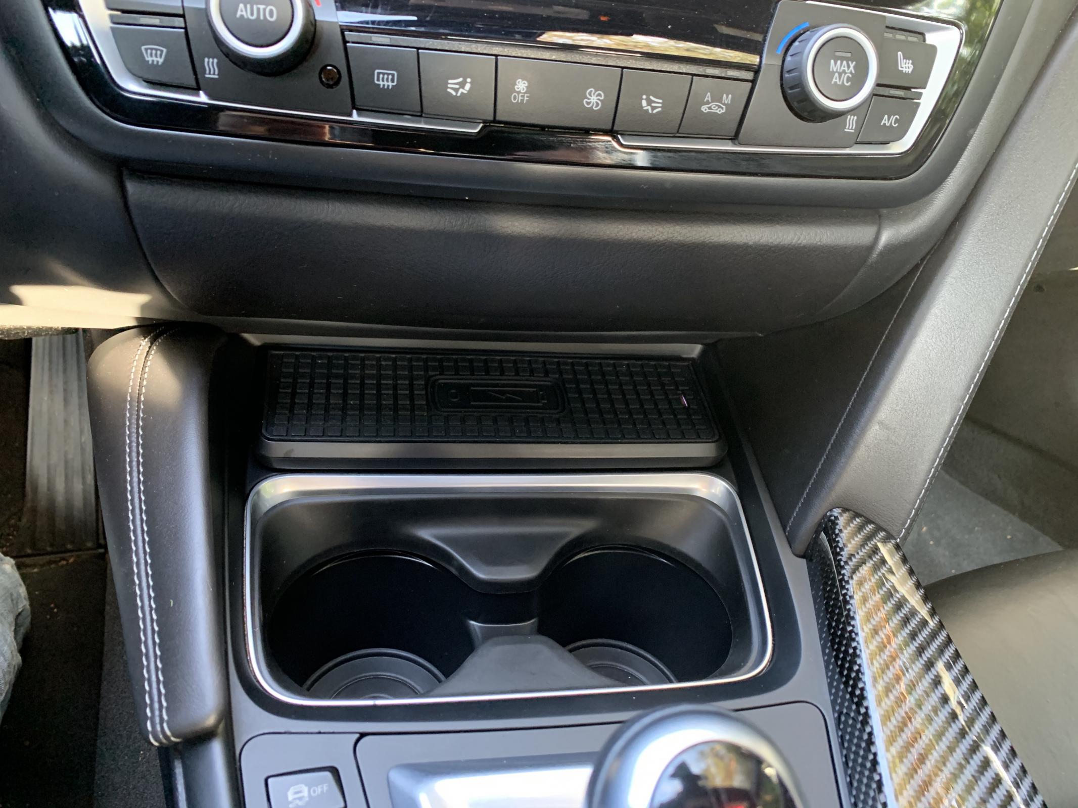

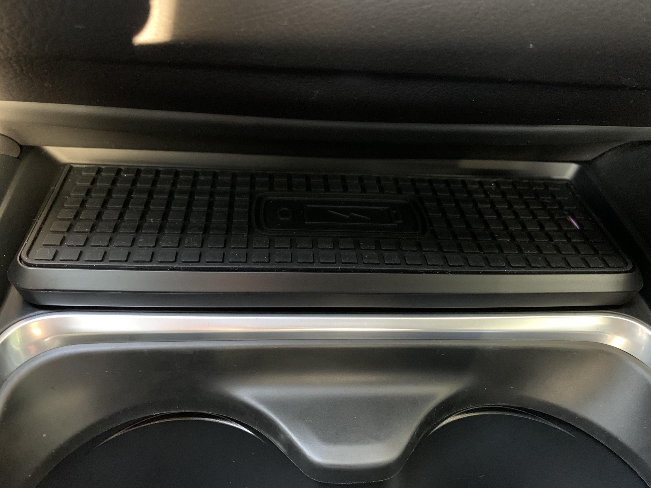

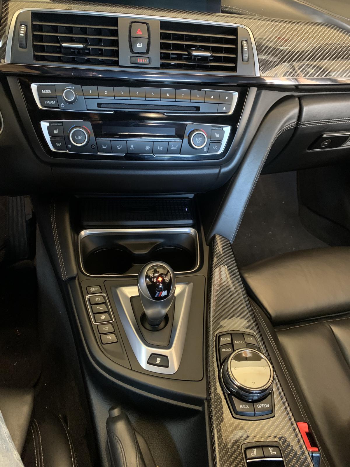

Here are some photos. It's not flush but I love how minimalist it looks compared to the Sighil charging pad I tried originally. This charging pad was much sleeker though it required a more intrusive install.
It seems to work fine though I haven't checked the charge rate yet. I attached it with double sided velcro so I can access the cigarette lighter and tray inside if needed. The rubber pad on top seems to keep my iphone xs with a slim TPU cover in place even during hard turns.
