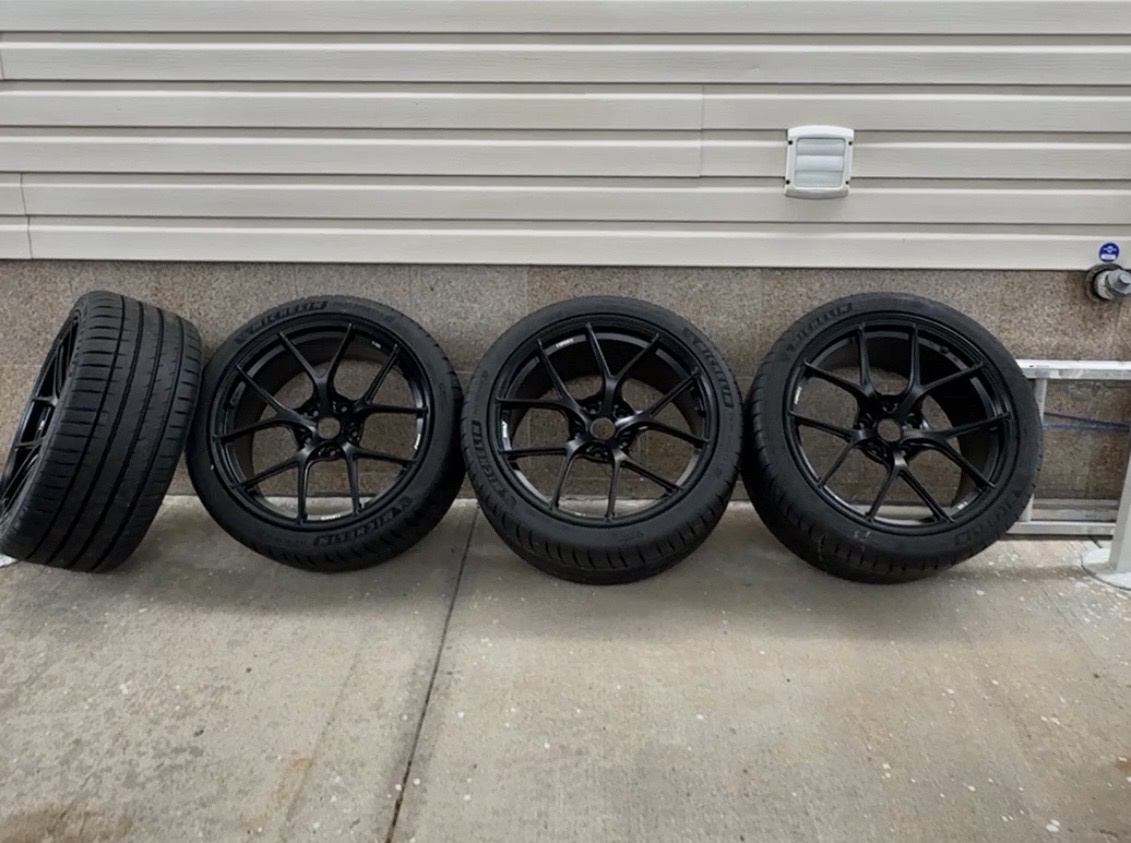

Installed 19" Titan 7 TS5 Black Wheels on My M4
I wanted to share my new wheel setup with you guys. I bought the 19” F8X set of TS5 wheels and went with 265/35 F and 305/30 R PS4S. I’m really digging the new wheels.
The 35 sidewall up front helps with the rough city roads. I’m finally running some 305s for the first time on the rear. No DSC issues. No rubbing. I’m on Eibach V1 springs. Traction is good.
The front wheel by itself weighed ~ 20 lbs. The rear wheel weighed ~ 22 lbs. Both 5 lbs lighter than each of my 666M wheels.
OEM G series center caps fit. I added teflon tape around the teeth of the center caps for a better fit. This is the look I’ve always wanted.

Looks great 👍

Thank you. You had a few posts I seen in the past about running 305/30-19 tires on your wheels that actually gave me peace of mind to go this route.

Yep. Same MPS4S in 265/35-19 and 305/30-19 on brushed dark clear R101LW. Similar split five spoke wheel designs.
